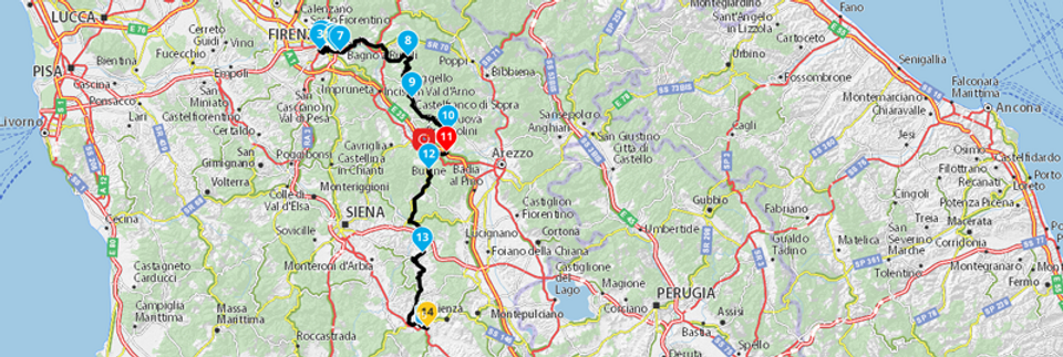

Ok so I signed up to a two week free trial of MyRoute App and Navigation next. Weather was good today so I thought I'd give it a workout in comparison with my Zumo XT. I prepared a route using Here maps in my route app and came up with this mostly minor roads with loads of junctions.
Imported it as a track into Basecamp Did the Direct route conversion thing using 33 points (same number as required by My route app to complete the Journey) The underlying track is visible and a small amount of variation but highly acceptable. (grey bits)
