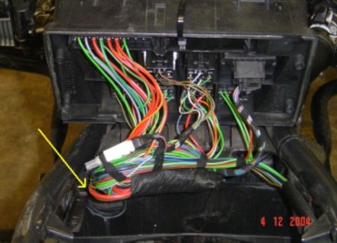

. Remove the top of the fuse box. This is a tight fit between the two frames rails; slowly flex the lid so that removal can be made easier. Warming the lid with a heat gun is strongly recommended as it allows the plastic lid to flex more and greatly assists in its removal.
ABOVE ALL………. “DO NOT TRY AND FORCE IT OUT!”
. Care should be taken not to subject any of the wires underneath to any undue strain.

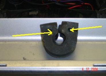

. Once the fusebox is clear of the frame, remove the large rubber grommet that is situated at the front of the fuse box that supports the main loom as it enters into it.
. There are two sealed slots in the grommet, carefully cut out both the slots and the centre of the holes.
. Replace the grommet and slide the two power cables though one of the slots. One is the main feed from battery; the other is the feed to the lights. The LED wire goes through the other slot.

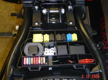

. Using the high adhesive taped backing provided in the kit, secure the Autoswitch inside the fuse box.
. Connect the Autoswitch control wires to the appropriate wires inside the fuse box.

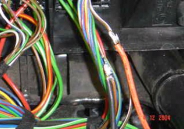

. The simplest way to connect to these wires is by utilizing the Scotchloc connectors that are provided within the kit. They are fine and are very quick and easy to use.
. But it should be noted as they make small indentations into the wires as they cut into the insulation; over a period of time this “could” result in a poor connection. It is therefore recommended that the joint is done by splicing back the insulation and soldering the feed wire to it, as per the photograph shown below.
. The soldered joint should then covered with insulation tape or better still heat shrink to avoid a possible short circuit to earth.

. Connect all the wires to appropriate relay connections, see Autoswitch & Relay wiring paragraphs on the first page.
. The relay is held in place by the foam provided. Simply place the foam around the relay and gently push it into the spare aperture.

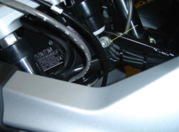

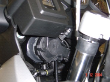

. Carefully route both the LED and the feed wire to the lights up along the frame and under the tank (if not removed) to the front of the bike. Extreme care are should be taken in the routing of these cables to avoid possible chaffing and the possibility of a potential short circuit to earth.
. It would aid the installation if the headlight assembly were also removed.
. The LED is held in place under the dashboard, using the self-adhesive cable tie base provided.
. Connect the positive wire from each of the lights to the feed wire from the Autoswitch
. Connect the negative wires (earth) from each light to a suitable earth point. Personally I utilize the M8 Allen bolt that is situated just under the ignition barrel for all the earths.
