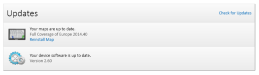

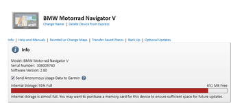

So, I've fitted a 32Gb card, updated to maps to 2024, used 2.98Gb on card, but internal memory is 27.2Mb free of 7.03Gb and I need to free it up.
I can't find the gmapsupp file mentioned earlier in this thread, and I'm about to put some big routes on.
Can someone point me to the latest thinking on this ?
Thanks.
I've taken what I hope is a low risk approach to start with. I live in the UK, so I've deleted non British help files, non British Keyboards, non British Text, non British Tracker, and non British Voice. This has made nearly 0.5Gb free, so a good start.
