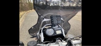

Hello Nin, was about to order a brodin active mount but you've put the brakes on that regarding water ingress,where you able to flip the mount so the power and pins are at the top . I've seen video of ram mounts in this orientation , could you also tell me which bar mount you used..thanks
Hi Jim
I use a Ram Tablet mount cut down to fit the Samsung, it worked well on thought roads in the Alps last year.
These are the setup-s on my airhead and TC.
Power supply wise I use one of the cables that connects to a magnetic insert in the USB-C

Hello Nin ,intriguing setup , I'm also now looking at a 3DAM interface plate connected into the main bmw connected ride cradle assembly which has amps connectivity therefore allowing a Rams or Brodit mount to be attached securely via your existing bmw key lock enabling to remove the whole unit overnight. I do like the magnetic power insert thanks...jim

What is the tab mount mounted to on the TC please
I bought the GSA overhoop for my GS but i cant mount the nav6 and tab on the same hoop (redundancy jic)
Your hoop looks to locate on the screen mounts , not seen that before ...
what is that your using?
Sorry I don’t have the bike any more, so can’t update the photos. But basically it was a ram ball on the standard GPS mount bar, connected via a ram bar to a ball on the back of the tab mount. I then tied the corners of the ram tab mount into two bolts through the screen to stop it jumping around.
