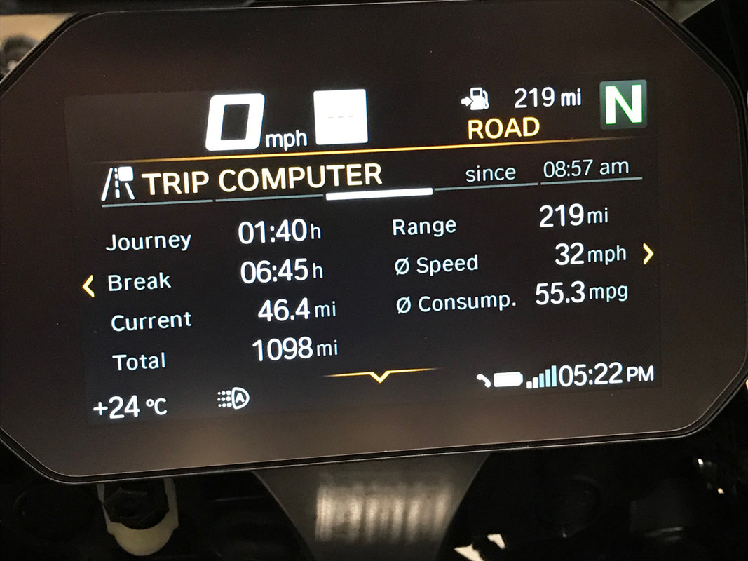

Just nipped out and had a look at mine. The average speed and consumption are shown for both the OBC and Trip Computer.
Thanks Richard - very good of you. Not sure about the terms OBC and Trip Computer - mine seems to offer 1 and 2 numbered versions of these readouts, which I thought corresponded to trip 1 and trip 2 mileages? I've never reset my trips so I think both give the full ODO reading. In any case you are getting a reading and I am not, so I wonder what the problem is with mine.
The OBC (on board computer) is the one that (in theory) never resets - and is number 1. Number 2 is the trip computer and can be reset manually or automatically.
According to the manual, it is also possible to reset the OBC through the menus.
Is your average speed also reset to zero?

OK - this is how my OBC and Trip Computer screens look, the mpg should be around 46 going by my fill up records:
Can’t really help with your mpg issue but I am surprised with your average 49mph over the lifetime of the bike. Do you spend all your time on fast A roads and avoid traffic lights etc?
Thanks for your input anyway - the photo of yours was helpful as it does seem to confirm that something is amiss with mine.
