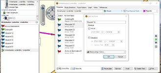

Select the route in the left, lower pane with double click.
Select a point in the popup.
In that window, either in the Properties or Route Options tab, you can select the activity profile.

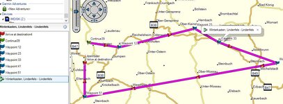

Just dropped the route into base camp hit recalculate and voila, did the same in map source and same result, as to whether it is going the way you want it to is another question.
Now that I have a new profile, its difficult to replicate what I did the first time :blast
Aha, you don’t get the option within a viapoint’s properties on a Mac.
Try these screenshots:
They don't display in the correct order but are named step1 through 4 and result.
